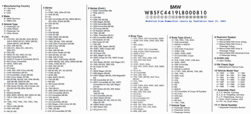

ETK-Vložením vin je zobrazena kompletně i výbava http://cz.bmwfans.info/parts-catalog
VIN Dekodér - Každý k vozu ukáze něco navíc
http://www.bmw-z1.com/VIN/VINdecode-e.cgi
https://cz.vindecoder.eu/bmw
http://www.vindecoder.pl/

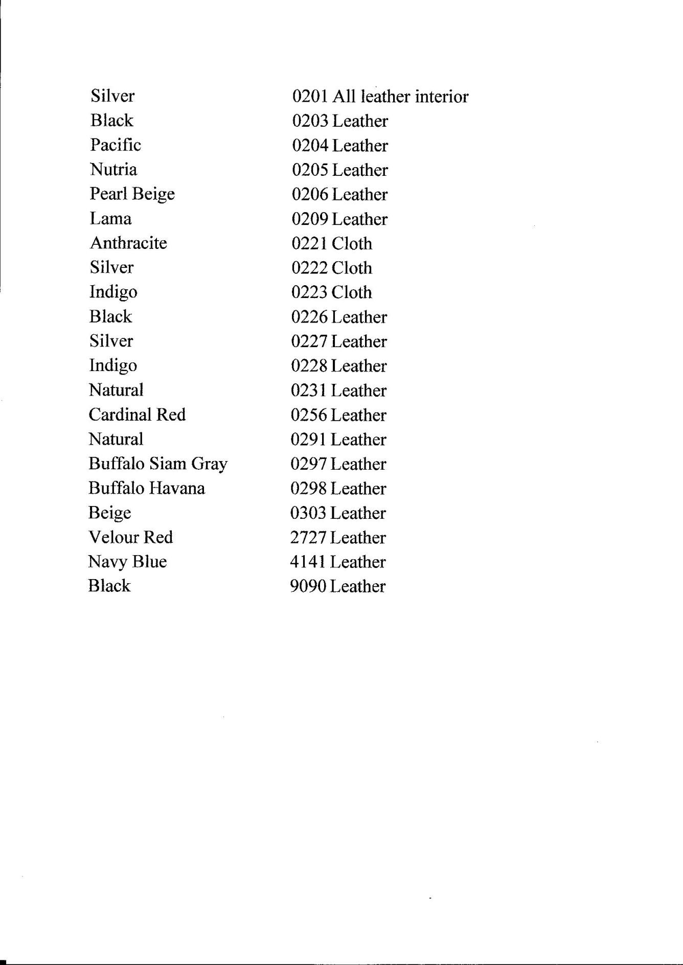

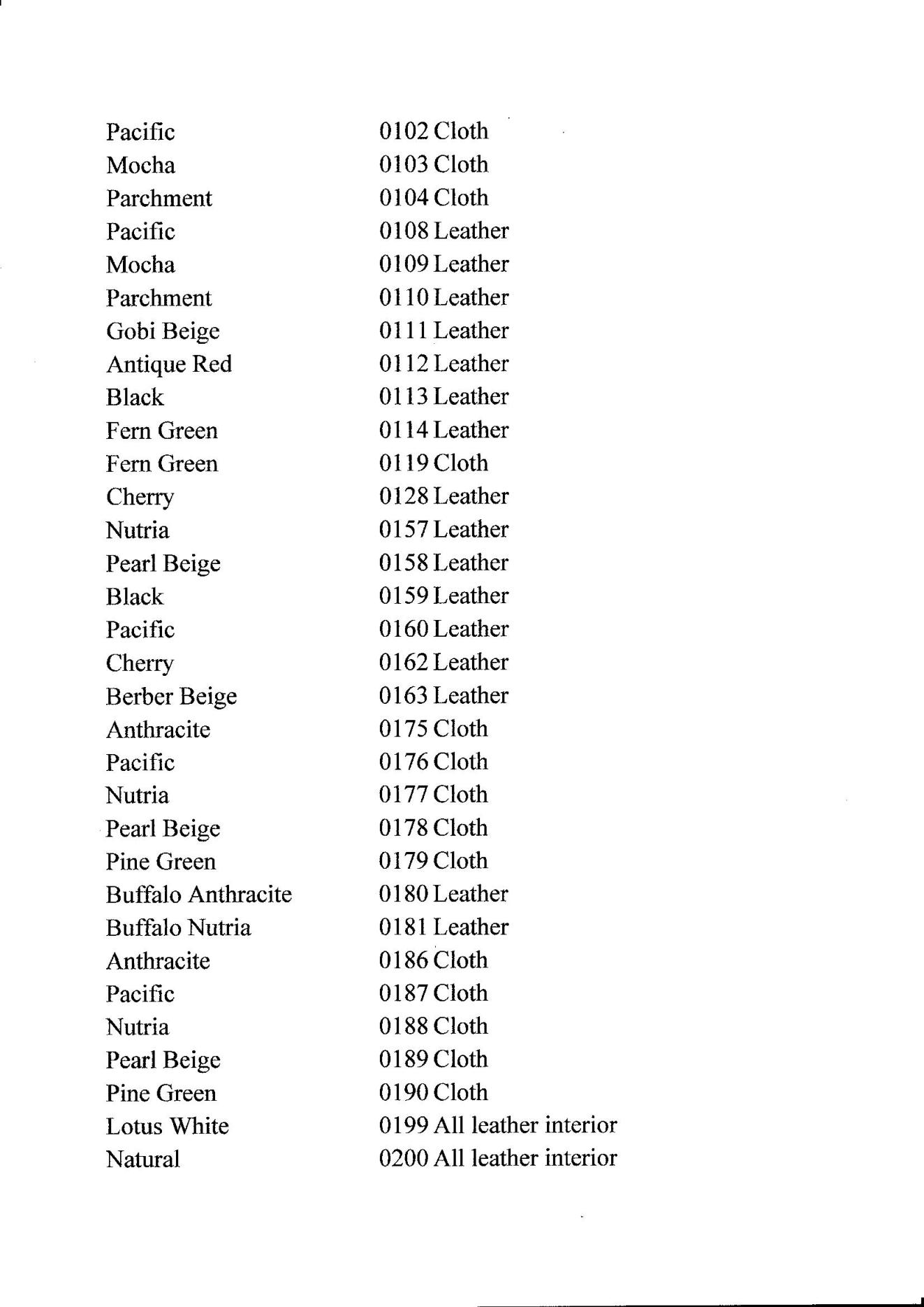

Vnější lak
Color Code Paint Color
012 Sierra Beige
013 Topas Brown - Metallic
021 Malaga
022 Inca
024 Verona
035 Garnet Red - Metallic
037 Fjord - Metallic
044 Pastel Blue
045 Arctic Blue - Metallic
052 Henna Red
054 Ocean Blue
055 Anthracite Gray - Metallic
060 Polaris - Metallic
070 Golf
075 Reseda Green - Metallic
078 Jade Green
079 Mint Green
085 Chamonix
086 Black
087 Graphite - Metallic
0128 Gazelle Beige
0138 Cinnabar Red
0139 Bronze Beige - Metallic
0140 Biscay Blue
0141 Cedar Green
0142 Sepia Brown
0143 Cashmere - Metallic
0146 Alpine White
0147 Safari Beige
0149 Sapphire Blue - Metallic
0151 Ascot Gray - Metallic
0152 Cypress Green - Metallic
0153 Olive Green - Metallic
0154 Brazil Brown - Metallic
0155 Karnel Red - Metallic
0157 Chestnut Red - Metallic
0170 Bahamas Beige - Metallic
0171 Opal Green - Metallic
0172 Carmine Red
0173 Lapis Blue
0176 Saturn Blue
0177 Agate Green - Metallic
0178 Baltic Blue - Metallic
0179 Acaia Green
0180 Basalt Blue
0181 Diamond Black - Metallic
0182 Emerald Green - Metallic
0184 Dolphin - Metallic
0185 Cosmos Blue - Metallic
0187 Savanna Beige
0188 Platana Green - Metallic
0189 Cirrus Blue - Metallic
0194 Pußta Green
0196 Sable Brown - Metallic
0198 Royal Blue - Metallic
0199 Burgundy Red - Metallic
0203 Salmon Silver - Metallic
